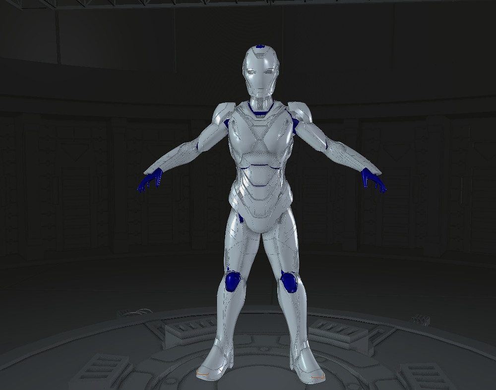

We have been 3D printing cosplay props for about two years now, but had never done anything more complex than a helmet. We aren't 3D modelers so our first job was to find a suit model that had the accuracy, quality, and the overall look we wanted. There are a few Rescue 3D models out there but @Do3D.com checked all the boxes for us. Often times it's difficult for female armor to look svelte and not "boxy" so this was one main reason we went with this model.
We used the program Armorsmith for all the sizing & scaling. We highly recommend this product as you can input your physical dimensions and scale each piece of armor individually to fit your body. No two people are alike and printing a 3D model at scale will most likely not work without a lot of modification.

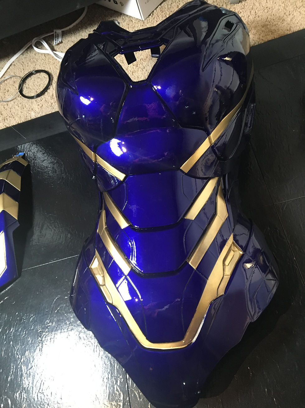

As for paint, we wanted this armor to "pop". We took the "hot rod paint job" seriously and went with a custom mixed three-stage Candy Paint from House of Kolor. This blue-purple paint consists of a ground coat, then several layers of candy coat (pearlescent and metal flake) and finally the 2k clear coat. We applied this as you would a car: we set up a paint booth in our garage and sprayed with a HVLP gravity-feed spray gun and air compressor.
The result is a really deep indigo blue-purple that color shifts depending on lighting. The resulting cosplay has been photographed as bright as blue or even a dark purple!
